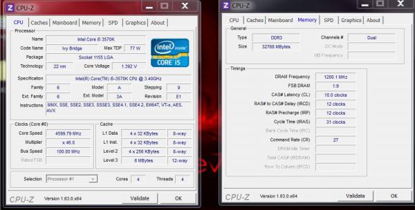

                  Do you have the latest BIOS, should have an option for 2133, if not may have a corrupt BIOS, which actual set do you have, the F3-10666CL9Q2-64GBZL or the F3-10666CL10Q2-64GBZL? The two run different timings and voltages (and will at 2133)
